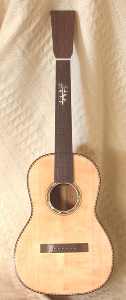

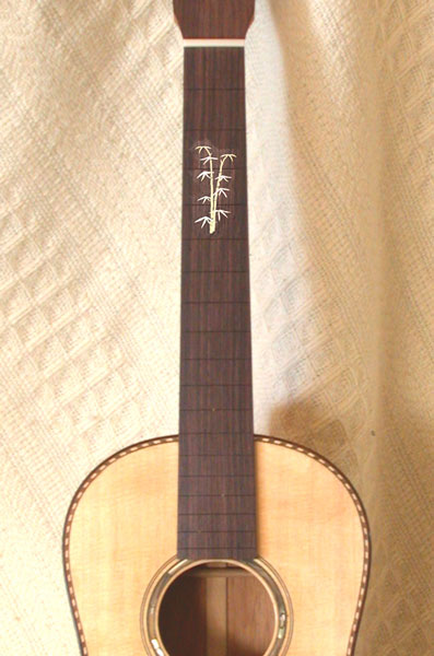

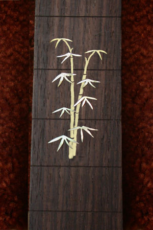

What with my surgeries and life and everything else, I just realized I have done just about zilch on my little size 5 koa since mid-October, with the exception of a few build sessions with FP. I've been scratching my head trying to come up with the right "look" for the bamboo inlay I want for the fretboard. I want a certain amount of Japanese look to it, like their traditional woodblock prints from around 100 years ago. I even bought some books on Japanese motifs used for printmaking for ideas on the aesthetics. But I didn't want too much of the Japanese look in it, just "some". So here's what I came up with. This is by no means done. About 2/3 of the leaves in the Photoshop mockup have actually been cut. None of the stem or trunk pieces are cut. They're shown sittin on the actual fretboard I'll be using. I'm planning on using this on 3rd to 5th frets, with little or no other inlays on the fb.
I am a little concerned about the fine cuts I'll be making in EIR and am thinking that I might have more success with such cuts being made in ebony. I really like the look of EIR over ebony on this guitar. But being based on the Martin size 5 scale length (so it's not so easy to have a new one cut and I'm without that capability), plus having bought the neck and fb already glued, I wonder if I'm too attached to the EIR. Any opinions or ideas on the wood selection, design, whatever?

PostPosted: Fri Nov 17, 2006 5:12 am
Love it Pat! That is a great design.
I would love to see it with the whole guitar to get a better feal for it.

PostPosted: Fri Nov 17, 2006 6:20 am
Pat, what if you were to flood the area with CA before you routed out the pattern? Do you think that would help prevent any chip out? I bet Craig or Paul could give you some advice I'm sure they done intricate thins in EIR before.
BTW, I like the design.JBreault39038.5980555556
PostPosted: Fri Nov 17, 2006 6:42 am
I like it, Pat! From your description, it looks like you achieved exactly what you intended.

PostPosted: Fri Nov 17, 2006 11:09 am
Posts: 4819
I really like it. I also really like woodcuts. What would you think of
splying the right branch out a bit, and the left branch half of a bit?

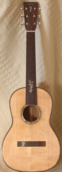

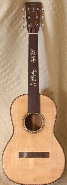

PostPosted: Fri Nov 17, 2006 1:08 pm
Well, I spent a good part of the day doodling around in Photoshop and another good part catching up friends on my latest activities and another part napping. It has been a good day for recovering.
Here are some photos of the whole guitar with the proposed inlay overlaid on the fretboard. The color on some of them is pretty poor. Sorry, wish I'd had better ones. I wonder if I'm going to get "austere" instead of "elegant in its simplicity," which is what I'd like. I'd appreciate any thoughts.
PostPosted: Fri Nov 17, 2006 1:13 pm
Posts: 4819
Your photoshop work is really good. Would you tease me and move it
down a half fret?
PostPosted: Sat Nov 18, 2006 12:59 am
I love that inlay Pat, simply beautiful! And so is that guitar, awesome!
Continue healing my friend, fun in the shop soon!

PostPosted: Sat Nov 18, 2006 3:50 am
Posts: 4819
Hey Pat
I agree. I like the inlay a lot, but it doesn't seem completely settled to me
either. Maybe down half a fret or even a whole fret?

Purely my personal view, but I think that inlay (which looks really nice by the way) would look better on the fretboard coming out of the body and centred on the 12th fret (or thereabouts). To me where it is detracts from the elegant long neck of the lovely little guitar. Maybe play about in photoshop and see how that looks.
I've no real experience of inlay but would have thoght that rosewood would be fine - Craig and Paul will be the experts here though.

I agree with Dave. Try centering it on the 12th fret. It looks a little crowded where it is. I still like the design, BTW; and your guitar is sweet!

Pat, I really like the inlay!   It has a very peaceful vibe to it. It seems the
positioning of the bamboo will look different when the shiney bits at the
HS are a part of the picture. The inlay (where it is now) may make the
overall design kind of top heavy when the tuners and HS inlay are in
place. (If it will have a HS inlay). I like dave's idea of the 12th. fret. That
might seem more balanced.   Just some thoughts for what it's worth,

As far as the inlay goes, can I be a little different? I'd move it to the headstock and leave the fingerboard clear. Just personal, as I like my fingerboards completely naked, no dots or anything. Mind you I pretty much like my headstocks like that as well. Just ignore me!

I like the inlay - what I think would look realy cool would be adding a longer one /same style - going in the opposite direction starting at about the 7th fret.
I think that would look sweet when seated in the lap when its being played.

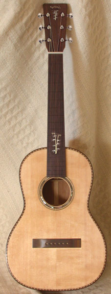

Thanks guys for the great ideas! I like having it near the body join too. My wife Maggie, who has an art background, has a great eye for proportion stuff. She took one look at it and said it needed to be closer to the body join, with some below the 12th fret. I'll post pics after I get it cleaned up in Photoshop, maybe with some pasted-on tuners.
PostPosted: Sat Nov 18, 2006 4:56 pm

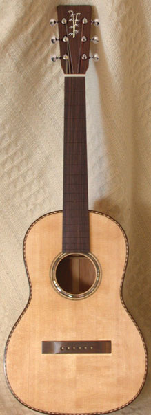

OK, here is a rendition for each suggestion. I've also faked in some tuners, (faked the bridge too, awhile ago, though it's the real one), a small headstock logo, and a hs inlay. If I use a logo, it will be my sylized f, wispy, tall and thin, in gold MOP.
burbank39040.0417013889
PostPosted: Sat Nov 18, 2006 5:10 pm
Amazing what photoshop will do...take note Billy/Hesh
Pat - I like the look of the top left hand corner best. That's looking really sweet.
Glad to see that you are up and about.
